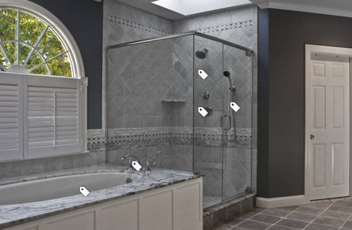

We are currently in the middle of renovating our house (in CA), and have run into a design/installation dilemma that I cannot seem to properly grasp. Hoping to use y'alls collective wisdom and experience to make the right call here.
Context: We are installing an under-mount bath tub (Kohler Underscore 66"x32") in our master bath, which is on the second floor, and the bathtub will be tiled all around. The one of the sides of the bathtub is adjacent to the shower, and we were are hoping to install the bathtub faucet on the same side. See image below for the dimensions and orientation of the bath.
Dilemma: My GC is telling me that the faucet will be installed only after the tiling is done (ok, sure). However, he is adamant that 1) we need to keep an access panel on the side of the bathtub frame both for the faucet installation, and for future maintenance purposes (should there be a leak), and (more amusingly) 2) he wont be able to install the faucet in the center of the bathtub, and that the faucet has to be near the edge since there is no way to extend the arms to install the faucet. See image below for a pictorial representation
Ask of you: While we are open to considering installing an access panel on the side, we are not sure how come the faucet cannot be installed in the center -- which is our preferred location. Can someone knowledgeable provide an independent opinion on this matter, and if there is something unique about an under-mount tubs with tiles on top (vs a single slab of marble/quartz/granite) that precludes installation of the faucet in this location. I have seen multiple pictures on the web which have this configuration installed (but usually with a single slab, see images below). Separately, it will also be useful to hear your opinions for or against installing an access panel, should you have an extreme one on the subject (e.g., it is a must have or access panels are the worst idea ever)
Thanks in advance

There may not be room physically for the faucets to fit on the tubs deck in the center of one end.
If there is room on the end center of the tub it may not be physically possible to install it unless it’s completed before the shower is installed, you can’t reach it with the shower there......
Future repairs would be impossible without tearing it out if the valves are installed in the center of the end.
I would install where the contractor is suggesting.
If it has a motor on the tub it’s required to have an access.
If it has a handshower hose it’s required there be access.
I would install an access regardless if it’s required or not to inspect for small leaks.
JG plumbing
Well-Known Member
Joined
Mar 26, 2021
Messages
997
Reaction score
318
Location
Iowa
I'm of the opinion (so is the code) any slip joint needs to be accessible. I would plan for an access panel becuse it makes good sense. Can you imagine tearing out your brand new tile for one of the many reasons you'd need to access the components that the tub is hiding? These reasons aren't always apparent during construction and testing, it can sometimes take a little while for a leak to show itself.
The faucet is a judgment call. I would think there should be a way to squeeze the faucet in there, but without being there you might just have to trust him.
Is this something the plumber is relaying to you through the GC? Or the GC's opinion without talking to the plumber?
Not sure what you have in total, but I would try to have the access panel on the other side of the opposite wall and have the faucet over there or have access from below.
