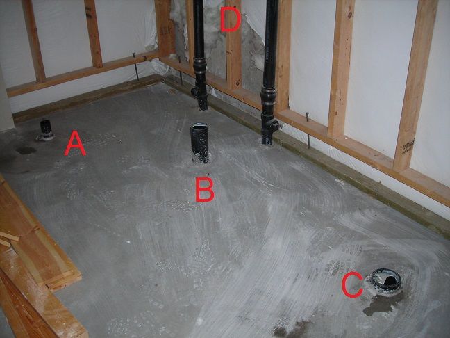

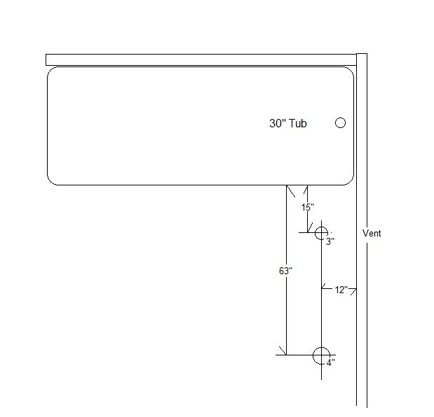

OK, I am finishing my basement, and I can’t figure out which stub out is for the toilet. The two pipes in the photo labeled "B" and "C" are the ones I am referring to.

1) Track house in Denver, Colorado, 10 years old.
2) Two possible toilet locations
3) 3” pipe "B", no p-trap, heads towards street, no smell at all, drains fine.
4) 4” pipe"C", no p-trap, heads towards street, no smell at all, drains fine.
The 3” seems to be the right one, but it is very tight using a 30” wide tub.
And if the 3” is for the toilet, what the heck is that 4“ for???
Any ideas? Even a WAG would help.

The 3" is for the toilet. Being 15" from the tub to the center of the toilet is OK. The 4" line should be the cleanout for the line it just needs a cleanout plug.

The 15 inches from the tub is code minimum. However, usually 4" pipe is turned up through the concrete so that a 4"x3" closet flange will glue inside of it. The layout in your picture doesn't make a whole lot of sense.
