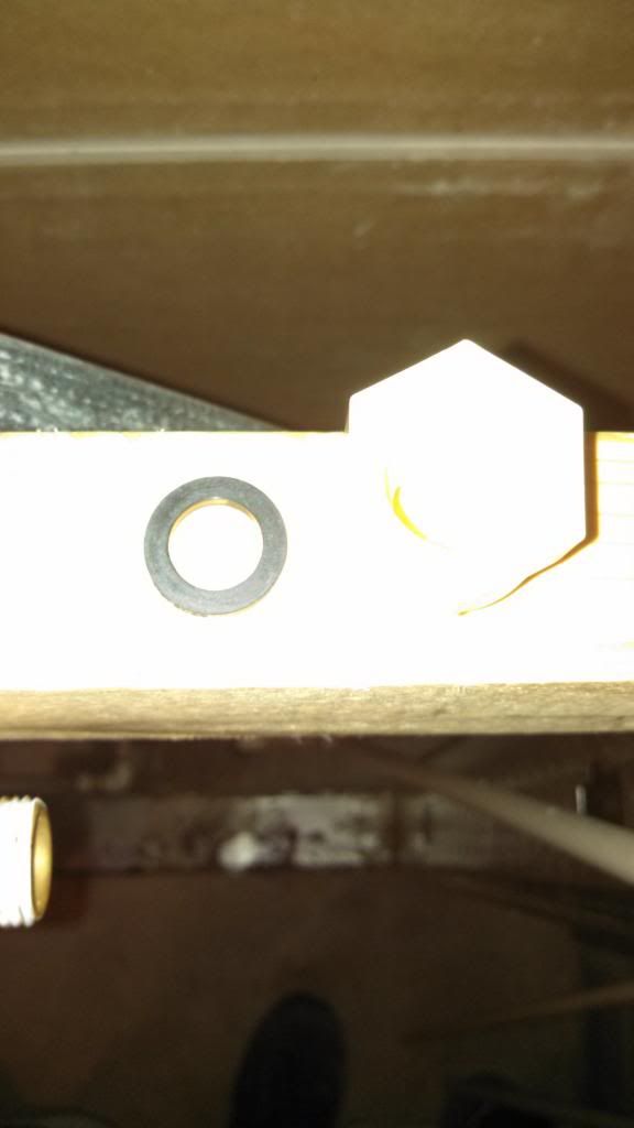

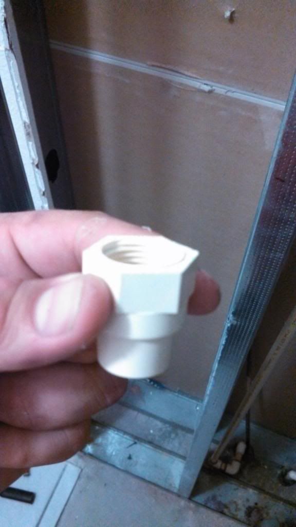

I am redoing our master shower. I bought and installed a glacier bay shower valve. My house is plumbed with 1/2" cpvc. I bought all the fittings and plumbed it tonight and when I turned the water on I had a fast drip from the cold side and slow drip from the hot side. I was told or read somewhere that the all plastic threaded fittings are not as good as the composite(plastic/metal) threaded fittings due to different rates of expansion with hot pipe, so I bought the composite metal/plastic threaded couplers. I thought I was doing the "right" thing, now I'm not sure if I used the correct fittings.
I used thread tape and finger tightened the fittings then gave about another half turn with a wrench. Both leak. Here's some pics:
You can see the drips in the last pic. I'm wondering if I'm using the wrong type fittings? I think they say "FTP" or something like that on them, which I have no idea what that means. I just thought nothing of it, but now am wondering if it's to adapt to a different type of pipe or something.
I cut and capped the pipes for now, but need to finish the job. I bought these fittings as recommended by the guy at home depot, but don't know that they are the right fittings for the job(I don't think most of those guys no any more than I do). Here's a pic of the fittings:
It has a rubber washer. I don't know if that's good or not, I'd think it's bad to use anything rubber in an inaccessible area due to the fact it will eventually fail.
Any help on what fittings I should use, or what I'm doing wrong? Thanks all.

Don't use those all plastic females. You used the correct fittings the first time. I would say you failed to tighten them enough. Redo it again using the brass females but use two wrenches when tightening them. You're working with brass on brass and they need to be tight. Use two wrenches when tightening them, one to tighten the other to hold back. The problem with the plastic females is overtime they have been known to split.

The fittings that you originally used are the correct ones, that is FIP, an acronym for Female Iron Pipe. 1/2 turn with a wrench is not nearly enough, they need to be fairly tight to compress the tape into the threads enough to seal. I personally use some pipe dope on top of the tape, but that preference causes long debates with some other plumbers.
Do not use the plastic female adaptors, you are asking for problems there.
