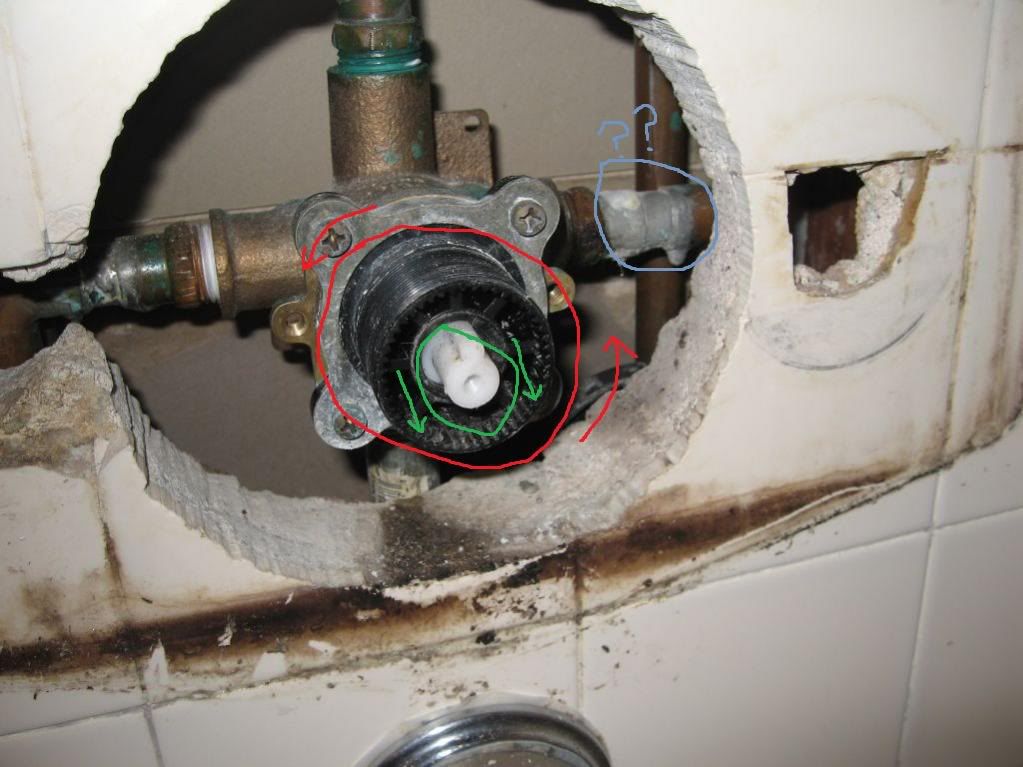

I've attempted to attach a snapshot of the valve. Can anyone tell the maker by looking at it?

Hrm, not sure of the make but I can make some semi-educated guesses as to how it comes apart.
The black part (circled in red) should unscrew counter-clockwise. You may need to grip it with pliers or a wrench, if so use a cloth or cardboard to make sure that you do not damage the outer threads.
The white part (circled in green) is your cartridge and should pull straight out after removing the black plastic ring. Make sure the water supply to the shower is shut off before doing this. Once removed you can either post a picture of the cartridge here and we can attempt to identify it for you, or take it to your local plumbing supply and they should be able to help.
There is a buildup of something on the hot water supply pipe (circled in blue) that looks suspiciously like lime or calcium from hard water. It is hard to tell from a picture. If this IS a scale buildup it may mean you have a slight leak from where that MIP is soldered to the pipe. It is possible that it is just drywall mud or grout or something similar dropped on the pipe from finishing one of the walls.
Lastly, it appears as if your shower valve and the supply pipes are just kind of "hovering" instead of being attached to anything. This could cause the valve to shake when water enters it, which could be causing your knock. While you have everything exposed, turn the shower on with a pair of pliers and see if you notice a slight thud or shaking around the valve.

Thank you very kindly for the comments and instructions! There's nothing like a picture to move things along, eh?
Another question: I am assuming this is a 'pressure balanced' unit, because its installation several years ago solved a longstanding problem of the shower running hot or cold when other faucets were used. Is the pressure balancing function inside the white cartridge, or is it another part that may have to be replaced elsewhere in the unit?

I THINK that you have a Price Pfister valve. If I am correct, you will need to shut the water off, drain the pressure, unscrew the 4 Phillips screws on the metal collar, and pull the cartridge out by grabbing the white stem with pliers and pulling away from the wall.
