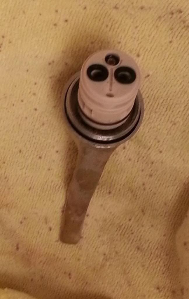

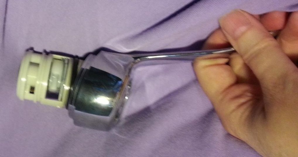

I'm trying to find a youtube instructional vid but they're all aimed at the kind of faucet that has the hex screw on the bottom. This one has a phillips screw on the top under a cheap plastic cover and there's no name ANYWHERE. Argh.
Thanks for any help you can offer.

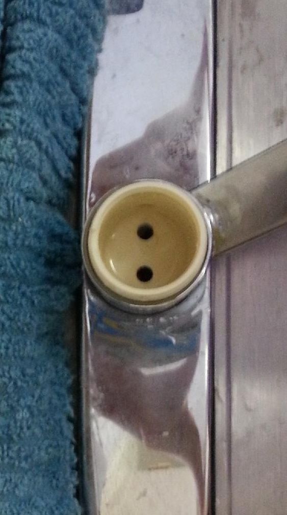

A couple more photos:

Sorry for the no-reply, Mary. I saw the post before, but I'm at work and need to get home to use my resources. There are literally hundreds of faucet types out there and if it's not familiar it may take some time. I'll try to get back to you tonight unless one of the other members gets to it first.
Sometimes we need to let visitors know that most forum members are simply enthusiasts and professionals that are volunteering their time to help. We do not get paid for our time. We have jobs, families and other personal activities in our lives, but still remain willing to help when time permits.
Just a little patience and we'll see what we can do.
Thanks, C.

This is the faucet breakdown and cartridge w/part number (with diverter). Hope this helps you out, Mary. Sorry again for the long wait.

It looks like a Sterling without a hose spray. Checkout page #16. The part # is STE 7006
http://arpny.com/pdf/SingleLeverCartridgesPtoZ.pdf

Looks like you may be right, John. Valley w/spray has a second 0-ring, Mary's faucet doesn't. But the Sterling doesn't have an o-ring on the cartridge face in the diverter port and Mary's faucet does. Hmmm, amazing similarities.
Mary, could you post a clear picture of the bottom face of the cartridge for us and let us know if you have a sprayer attachment for the faucet.
It looks like John is right, but it just kills me that he kicks my butt at these things.
